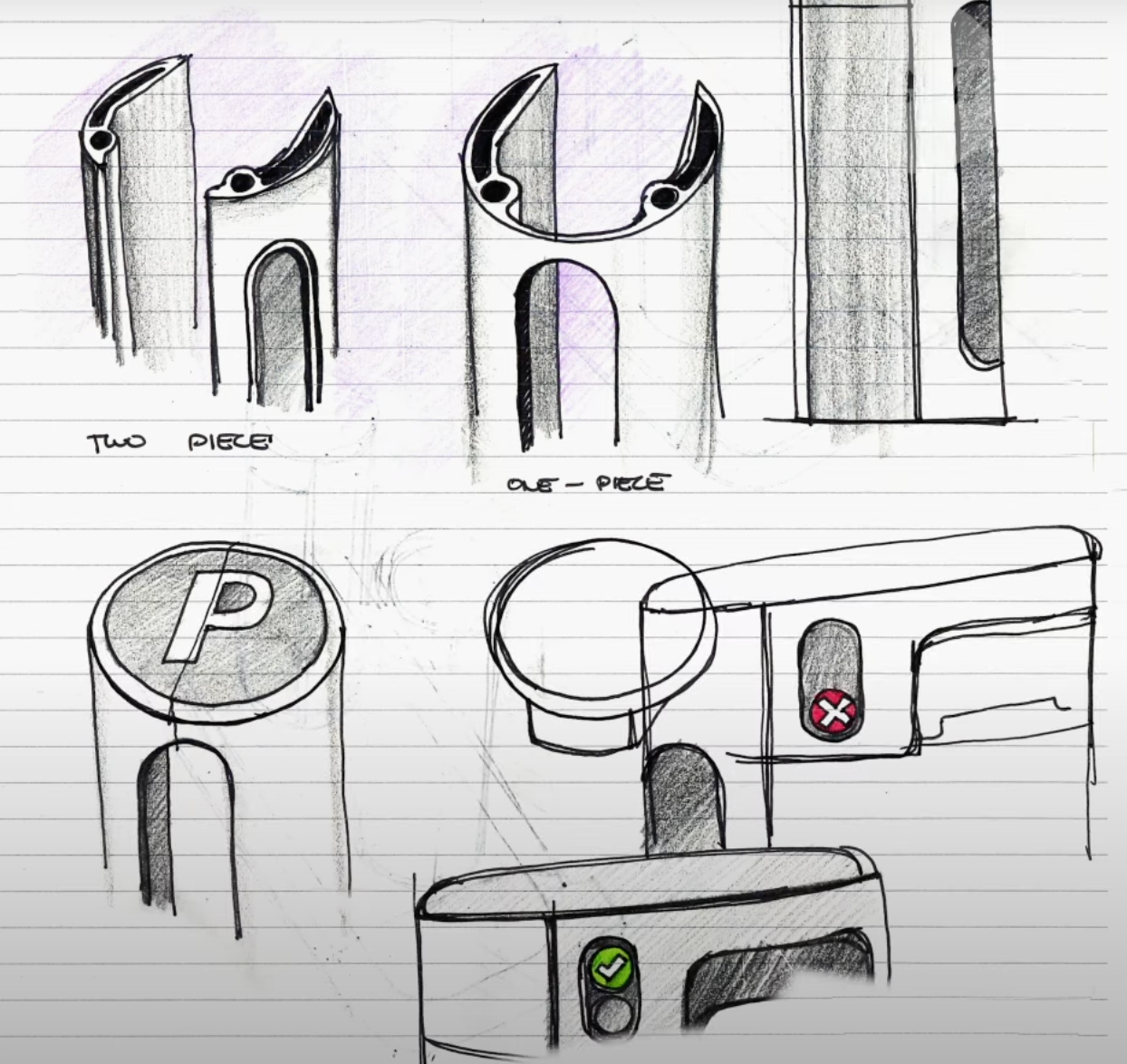

From Rev: Meet Pillar, Lyft’s New Dock
Pillar has landed in New York. Have you found one in the wild?
Lyft’s new docks are popping up in cities across the country, and New Yorkers are already seeing Pillar in a few locations.
Developed to be seamlessly integrated into the cityscape, Pillar is independently powered, independently connected, and charges bikes right at the dock providing a more sustainable way to ensure bikes are ready to get riders where they’re going. This change also makes dock placement more flexible. Check out more about the new docks in Rev’s video debuting Pillar here
